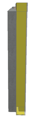

Hi i am working with composite elements for a muliti story building its my first project using archicad and i am self-taught so I definitely have a lot to learn.
My problem is that i have a composite wall and it consists of concrete, insulation and plaster. The concretes model height is 2.81 m but the other two's height is 3.11 which is also Parent elements (whole wall) height. now i would like to create a component schedule where actual height of skins is shown. Because for now it only shows 3.11 for all three skins. What is the work around. Most of the post i found is that the best practice would be just modeling them seperatly but that doesnt seem like the right work flow. I am sincerly gratefull for any response!

The posts you find are true in case you have a composite wall.
Problem is that the composite created with wall can get you correct area of the skin and volume as well which will reflect all the automatic connections based on building material priority and SEO (solid element operations) too.
But height is an parameter which is baked into wall settings.
One workaround would be to use complex profile and set height modifiers for each skin. For this to correctly show in schedule you should probably set a few properties for each material and then assign it in the properties for that building material, but I can't imagine to do this in a whole project.

So what im getting is there is actually no work around other than to build 3 seperate walls. I even tried creating my custom logic to calculate height and then to append it to materials of respective skins but materials dont allow for their properties to have expressions in them it says its unavailable. I also watched a video on this from ArchINTENSIVE 2023 and the talker had his logic written but from what i saw he also didnt use that many composites.

There is no skin height parameter probably because the skin height could vary depending on how the different parts of a wall intersect with other elements such as ceiling, beams and slabs.
If the skin height is constant then you could calculate the height by dividing the skin area by the wall length. You cannot, unfortunately, use the expression to automate the calc as component (Bmat) data cannot be used in expression, so you'd have to export the schedule to Excel and use the excel formula for automation.
