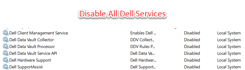

Hi, I have installed Archicad 25 INT on a new PC on Windows 11 ProX64:
Intel(R) Core(TM) i9-10900X CPU @ 3.70GHz
RAM 32.0 GB, 64-bit operating system, x64-based processor
GPU RTX A4000 16GB, Eizo monitor 32inch SCREEN RESOLUTION 3840X2160
When I open the Layer Manager window the operation is too slow and the blue circle is spinning for about 5-10 seconds. The stretching of the window is also problematic, the movement is not smooth, it is very slow and the circle is spinning. The movement of the whole window is OK.
The above check was done with version 5005 and also with the latest version 5010, the results are the same.
On a check with other 2 PCs this problem does not appear.
I have noticed that the more the Layers, the more slow motion-stack problem.
This is happening only with the LAYER window, all other windows work fine.
Has anybody faced with the same problem?
Takis.

2022-04-10 06:03 PM
have you installed the latest GPU drivers?
have you uninstalled all Dell bloat?
2022-04-11 09:18 AM
Hi John, yes I did already.
Best regards,
Takis
2022-04-15 08:34 PM
Hi all, the problem has been resolved today. The problem was caused by Dell Services.
Dell Services cannot be uninstalled but they can be changed to Disable status.
They change automatically back to Enable every time there is a Windows update.
Thanks for all the help.
Takis
