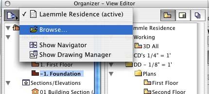

How do I move drawings in the layout book from one ArchiCAD file to another? I have Master layouts in a start-up file which is used every time. After completing a floor plan in one file I would like to bring in the elevation from another file onto layout sheet #2.
Is this the best way to bring the two together or should the layout sheets be plotted separately from each file?
5 REPLIES 5
You have the option to open up a different project in the left side of your organizer and drag the drawings into your layout book. Click on the upper left button in your "Organizer-view editor" and browse for the project
