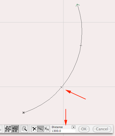

another way is to use your special snaps . . .
it involves placing the line longer than you need first - next set up your special snaps to show increments by 'distance' and enter the value of the distance you need.
hover your mouse over the end of the arc that you want to measure from and the snaps points will appear. grab the other end of the line and stretch back to it. be quick!

There is with straight lines, using the special snap constraints, but not with arcs AFAIK.
You could also force a guideline (` key) using your method if you didn't want to rush, but you'll need to be conscientious about where you placed your cursor to show the special snap points. Hover close to the originating end of the arc.
there may be an easier 'on-the-fly' method, but i didn't investigate too thoroughly . . . (link will set me straight if there is! )
~/archiben
Geniusly simple solution...
You could also place a hotspot, and then stretch back the arc at a relaxed pace.
