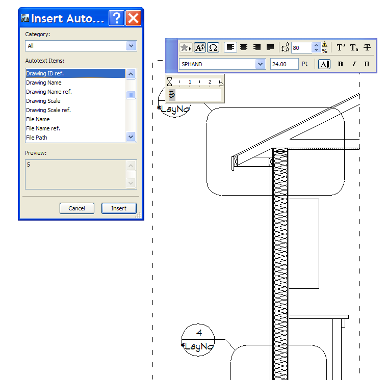

On my foundation plan (model view) just for example, I have markers I want to link to section type details. I don't show both ends of the section marker, just one end. The kind of marker you might place on a slab edge or at steps...that sort of thing.
I want that marker linked to a Detail. Often the Detail I need this linked to is a Detail created with the Detail Tool in a Section. The problem is that I can link that sort of little marker to a Section and have all of the reference ID's work well in the Layout sheet but I can not seem to make this work if I try to link it to a Detail.
This seems like a very common way of referencing. Is there a special marker or something that needs to be used for this instead of a Section Marker ?
If a Detail Marker could be made to look like one of these little section markers I think my problem would be solved.

Steve Jepson
getting close to a solution but need some help.
" Set as Autotext Refrence" could also be part of a quick solution.
Steve Jepson
That was it. "Set as Autotext Reference. Is the "easy" solution I was looking for to keep track of the reference numbers in Layout properly.
After you "Set as Autotext Reference" a Detail, Drawing, Cross Section in your Layout it creates a new Autotext that you can place in the reference number area of your section. Now the reference marker in your Section will match the Detail or Drawing the Autotext was created with.
This is all I need now to get what I want with out a lot of effort.
I apologize for this example drawing it is only a quickie to use for illustrating the technique. The markers are not even in the correct location.
Steve Jepson
see picture
Steve wrote:
After you "Set as Autotext Reference" a Detail or Drawing in your Layout it creates a new Autotext that you can place in the reference number area of your section. Now the reference marker in your Section will match the Detail or Drawing the Autotext was created with.
This sounds great, Steve. But I can't find any place in a section marker dialog box that will accept Autotext References. Where exactly are you placing this Autotext?
