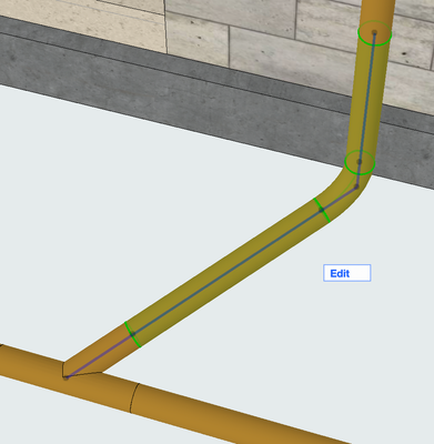

@Balint Kezer Pain point advice please - On plan I want to move the vertical pipe & bend at the bottom. How do I do this if marquee doesn't work? Do we have to resort to 3D editing?

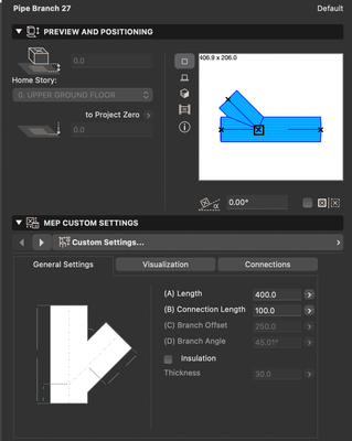

@Balint Kezer Couple of Bugs:
1. Adding a second branch to a pipe run can result in the previous branch disconnecting.
2. The branch offset value has been fixed at 250mm, this can be too long in some situations. Either make all lengths adjustable or work to a real world minimum dimension, not an arbitrary value that suits the programmer.
Wish: We should be able to form a branch connection in the 3D window?
Hi Trevor,
To the modelling challenge you described above, currently 3D editing is your best bet.
To the other points you raised:
  1. Could you provide a bit more information about this? Is this happening when you are trying to place two branches close to each other? I guess the pipes where this happens are sloped one, right?
  2. Actually you can predefine this currently from the branch element. If you open up the Branch Tools Settings, you can see that it is unlocked and the minimum amount is based on the Length of the main pipe.
Could you elaborate on the 3D branch connection, as I might not understand what you want to do.

Hi Balint,
Thanks for the response.
1. Let me come back to you on the two branch bug (I am pressed for time just now). It isn't a close proximity issue, it happens even on a long pipe. It happens with sloped branches connecting to a sloped main pipe. When it happens the branch fitting is removed and a single node is left at the branch meeting point.
2. What you describe isn't entirely true. The branch offset value (C) is locked. I can understand the angle being locked, but the (A), (B) & (C) values needs to be adjustable. This applies to all the branch objects.
Making a 3D branch connection isn't always possible. It does work, I have just tested it, but sometimes dragging the end of a branch to connect with the main pipe doesn't highlight the main pipe base line and the hammer doesn't appear. I have a feeling this has more to do with the fundamental operation of AC rather than the MEP development.
Regarding the branch offset. It is possible to adjust in the default setting for the branch tool which then is used when creating a branch using the route tool.... smooth right?
It is also possible to adjust it in a placed unconnected branch (drag copy) IF you first open and close the settings dialog once..... and you cant really reconnect the branch as all branches without three connections disappears.....
Confirmed. Well spotted!
So work around for now... Drag branch copy : open settings : close settings : open settings : edit : close settings : transfer setting with syringe to update placed branches.
