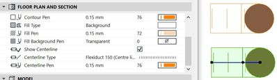

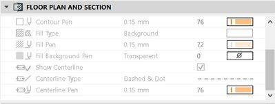

So I presume this would be the correct thread to ask where the ability to change the outline line type for ducts has gone? Is this another feature that has gone missing from the AC27 'refresh' of the MEP tools or have I just been unable to find where it is now hidden?
Archicad 26: Can use symbol lines on the floor plan display to change duct outlines
Archicad 27: Appears to be missing a comparable option
Admittedly, I think this was slightly broken in 26, but it achieved the desired end ie. setting an outline line type separate from the centreline type. In 27 objects that are not ducts (eg. a duct branch) seem to use the old settings, but now you need to select 'Override Object's Line Types' to change the outline line type, however this also changes the centreline... A dedicated outline line type should be provided.
On a related note, how do we override the cut fill and pens (eg. on a vertical duct that is being sectioned in plan)? Again, a work around could be found on AC26 by going to the 'All Parameters' page and changing the Connection Symbol Fill and Pens but I am struggling to find anything comparable on AC27. I also suspect it was slightly broken again in 26: After all, why does a connection symbol fill/pen adjust the appearance of a vertical duct that is sectioned in plan?
