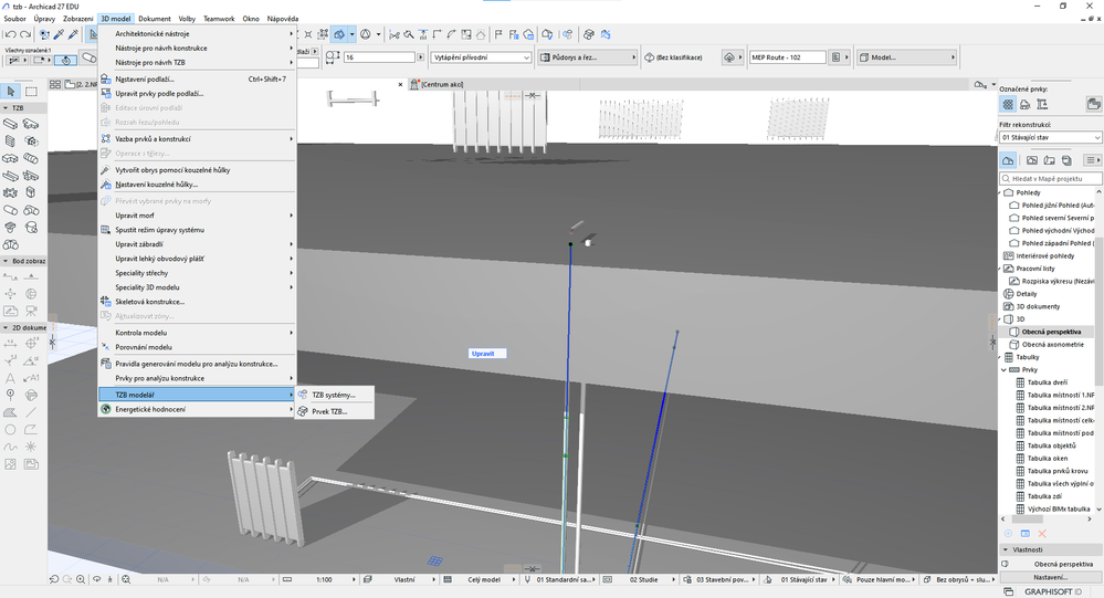

Hello Archicad Community,
I am using the educational version of Archicad 27, and I cannot find the MEP Routing option in the interface or anywhere within the program. Could someone please explain why this option is missing and if there is any way to install or enable it?
Thank you!
3 Replies 3
Akpocky
The old MEP Modeler was removed in AC27 so there is no MEP routing in AC27. You can use pipe tool to create pipe route but it can't use all equipment like the old MEP Modeler.

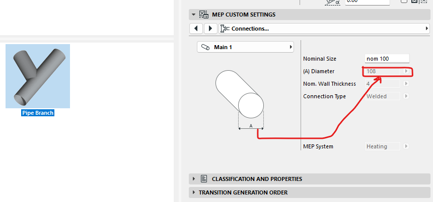

  • Hello. can you help me?  i have problem in Archicad 28.  i can't change Diameter of  Pipe Branch . Screenshot 2026-04-24 202315.png
Claudiu Serban
i think it auto scales. You need to change the dimensions of the routes leading into and out of the branch.
