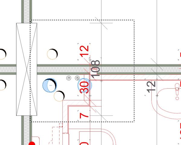

Hello, Is there a way to have the graphic symbol in the MEP plan in a straight line. Indeed on the plan I have pipes under the ground floor slab in a solid line and heating ducts on the ceiling of the slab on the ground floor which should be displayed in a straight line, in order to differentiate their situation in the plan. (pipe -50cm from the ground floor and heating +350cm from the ground floor). this for archicad 28

Here are some screenshots. We can see that the symbol in the plan is poorly represented. The lower deviation should be in view and not in a cut segment. In addition, it is redisplayed in the upper floors. Which is not desired.
Camu
so, it seems that the French version of the MEP does not work for the plan display according to the height of the floor. the international version does. This MEP definitely has a really slow delivery. Grrr
