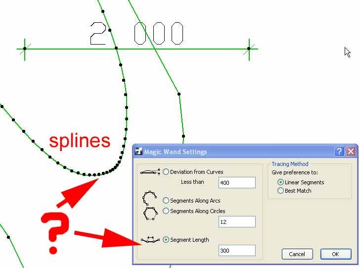

In the past I have been able to reduce the number of nodes on a polyline imported from autocad to use as ridgeline in the mseh tool. In the magic wnad setting box under the Tools menu I have set the radio button to segment length of 5' and have tried both tracing methods because I am not sure which method to choose. In the past on previous versions of ArchiCad this worked quite well. I cannot seem to get it to work in ArchiCad 9.0 or ArchiCad 8.1. Is it a bug or am I doing somethin wrong?

David,
I just tested the magic wand tool in AC 8.1 on a spline with the
line tool selected and it worked like it used to.
When I set the tracing method to best match I get arc segments.
When I set the tracing method to linear segments I get line segments
that are no smaller than set in the line length field in the left panel.

David,
I did some testing and I now understand why you have to convert
the AutoCad line segments into splines.
The magic wand tool apparently ignores
settings in the left panel such as line length setting
when it is tracing straight line segments with straight line segments.
It just imitates the original chain of lines.
If this true then it is unfortunate and deserves a statement in the wish list.
I can't think of any reason why Graphisoft would think that this overriding
of user defined settings could be a feature.

Any news on this? I have a client with a dwg file with solines as te terrain and the nodes are horribly dense which causes AC to stop adding the splines to the mesh after a while, and they have done only half the model.
I tried and tried and came up with the same result as Peter D in 2005. I don't want to recommend a manual work around but I might have to just to have the model working.
Look at the ridicolous imaage attached.
/Mats

Mats,
Find the technique for converting the splines to terrains described in the ArchiGuide tips.
The problem here is that the tracing is too fine; it has to be less detailed in order to succeed - in any software ...

I thought I would say a few things on this topic. The series of small lines representing the contours (ridges) that show up when importing a DWG might be the result of an option in your dwg translator (convert splines to polylines). I have at times had to do the same work around of first creating a magic wanding a spline and then using the splines I created and appropriate magic wand settings to magic wand the "ridges" in the mesh tool. As a general rule I always create new splines to represent my contours on my site plans versus using what comes straight from the engineer. Another item I discovered with the mesh tool is it is relatively fast to eliminate nodes along a single ridge in a mesh that is already created. Your can eliminate 10 nodes at once (or more) simply by repositioning one of the nodes to a different node (in this example 10 nodes away on the same ridge) and all of the nodes in between will be eliminated.
