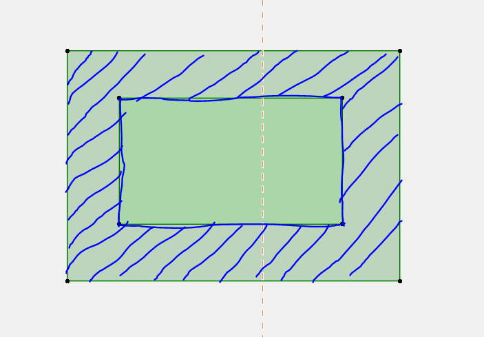

Hi there,
I would like to know how to subtract the internal fill from the external fill please, so you're just left with the blue area as a fill.
Kind regards,
1 Reply 1
CosminF
Select your fill, select the fill tool and draw inside your big one. And it will substract a hole.
And to substract an existing fill/ shape, you can use the magic wand (default shortcut: spacebar) to select it.
