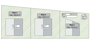

I think I know lots for modelling building and a terrain but I now work for a company  which does lots of masterplanning.  As an example 28 houses on a plot. I made the house types from the old days to objects to use them but I am wondering  whether there is a better way or things  which could be better.
Yesterday I wanted just to show the different plots with a hatch and give it properties which the label tool can pick up but failed ( i managed plot name with elements id manager and the plot size. What is missing is the house type and as planned and handed).

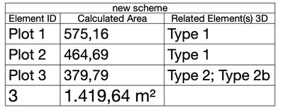

Maybe this is something you can use. You can draw the plot with zones and place the objects of the different houses in the zones. With a label on the lot you display the area and with a label on the object you display the type. You could also create a schedule in which the plots (zones) are displayed with the associated objects (types).
