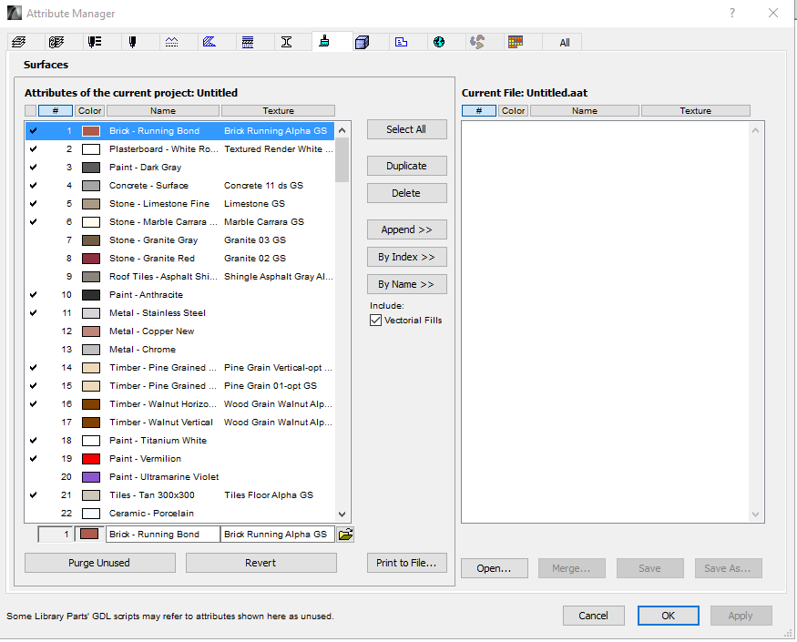

This becomes a problem for me because some day because I work in 3ds max and my maximum multimaterial is 999, dont know how far archicad allows the materials ID's to go. Also I think it is a mess with spaces inbetween.
Hope you understand the question.

i thought he might have been talking about the index number in the Attribute manager and referring more about surfaces than building materials (although it is similar for both).
If you delete surfaces, then that will create the gaps in the numbering that was mentioned and creating new surfaces will be added to the end of the list hence 550-551.
I haven't had any issue with the numbering not being sequential, but I suppose you could use the attribute manager to move surfaces back and forth using append or by Index to fill in gaps, but it gets mess as you don't want to overwrite or delete things, plus you have to rename and delete and replace surfaces

Thank you for all your answers.
Yes I think that tiggerF is right, as you can see, im no expert in Archicad, I havent even installed the program on my pc. But the screenshot that you provide looks right to me. I have huge gaps of several hundred empty ID numbers on the materials, so over the range of 550 materials - maybe 200 materials is in use.

jakobs:
Not easy to do, here is a post with one method: New attributes create with highest index number.
