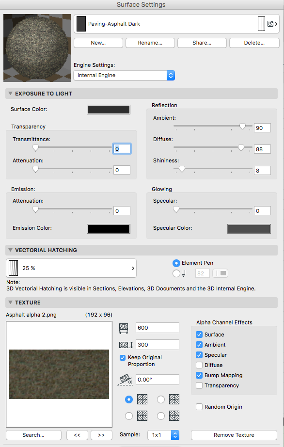

Thanks for your continued assistance, not sure where I'm going wrong, please see attached
Other attachment (limited to 1)
alemanda
it's right.
be sure that in MVO (Model View Options) the cover fills are not override
