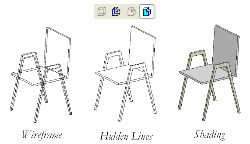

Your solution is fine if he can use Hidden Line, but not for Wireframe.
David
