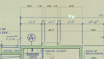

I measured between wall - then I measured the measurement
AND they are 1" different????  HELP Please as this is not a good start

The background is there but I am comparing two dimensions.
The first string is snapped ot the walls placed in Archicad
The 2nd wall measures the string of dimensions.
The 2nd string of dimensions add up to 1" more that the measurement from the start to the finish of the first string

Change your dimension settings to show as much decimal accuracy as you can.
You will probably find the walls are each a fraction less than they show - so they will be rounding up to the values you see due to your settings.
But when measuring the overall, there are enough fractional errors to make that one dimension round down to what you see.
i.e. 10' 1¾" will round up to 10' 2"
But 10' 1¾" + 10' 1¾" + 10' 1¾" will round down to 30' 5" (actually 30' 5¼").
This is clearly due to rounding error. Best practice is to input walls and other entities based on exact dimensions, rather than relying on a dimension display. (What is displaying in the tracker may be 1'-4", when you are actually drawing 1'-3 5/8" because you've turned on display fractions to the nearest inch, say.)
