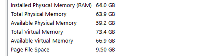

When operating in the 3D view, the computer freezes and displays the message below. Does anyone know if this is a computer hardware/ software issue of if it is a specific CAD issue that others have come across?

depending on the size of the Archicad projects you have open (you've got 4), it will affect the computer's performance, seeing as you're using 98% of your memory. this might be a hardware limitation at your end.
perhaps closing down a few of those AC projects? or reducing the file size of those projects you have open? you can reduce the file size by reducing your project's loaded library for a start.  using libraries that do not have thousands / millions of polygons per object.

It is a hardware issue.
You either don't have a lot of RAM available (to many applications open?) or check the available space on your hard drive - it may be very full.
shouldn't be a RAM issue, there is more than enough to cope, the file size itself is only 44k. as for applications open, its really only Outlook, CAD, Teams and Chrome that are the main users. Thank you for your response

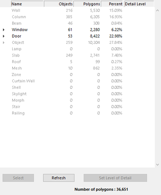

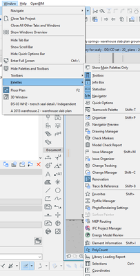

can you do a Polycount operation on each of those files you have open?
Window > Palettes > PolyCount

yep.... 348k,
Gerry Leonor
Teamwork file that's 509Mb in size.
looks like you've got a Godzilla object there, or two.
