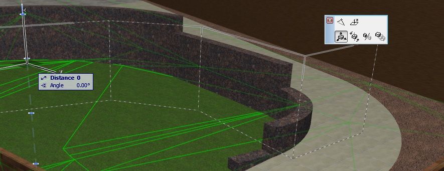

I am working with on a project that sits on a slopy site. When I click on the mesh lines to edit the height of the terrain, sometimes I get a "add point" option, which is very useful but sometimes I get only the move and lift options, does anybody know why this happens or what I am doing differently in both cases? Photos of the floating tool tab attached.

And this is the when it gives me the add point option.
Do you have the mesh tool active in both cases?
s2art,
Thank you very much for the reply. I noticed that the mesh tool needs to be active for the "add point" to appear. But still, it doesn't always work as sometimes I click and all it does is try and create another mesh on top of the one that already exists.
s2art,
I think I got the hang of it after you reply. Thank you very much for point out the mesh tool needs to be active.
