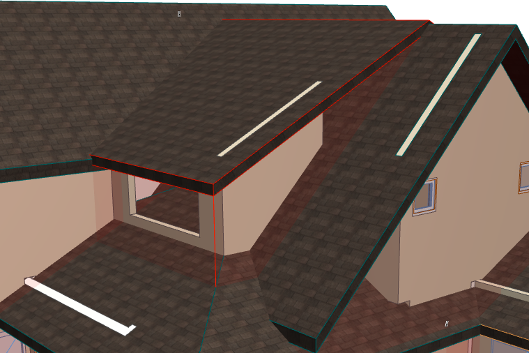

I did it before but now I can't....why is the wall still showing on the roof after trimming. How do i get to trim to underside of the roof?

Lilian:
See this thread: How To Get Rid of Wall Intersections for a Clean Look.

Thanks Barry...
I am having trouble finding the Wall Settings > Model > enable End Surfaces: Override using Adjoining Walls...
That setting is not relevant to the problem you posted, and is not available in AC17.

Thanks David.
I used the SEO instead and walls are trimmed to underside of roof.
