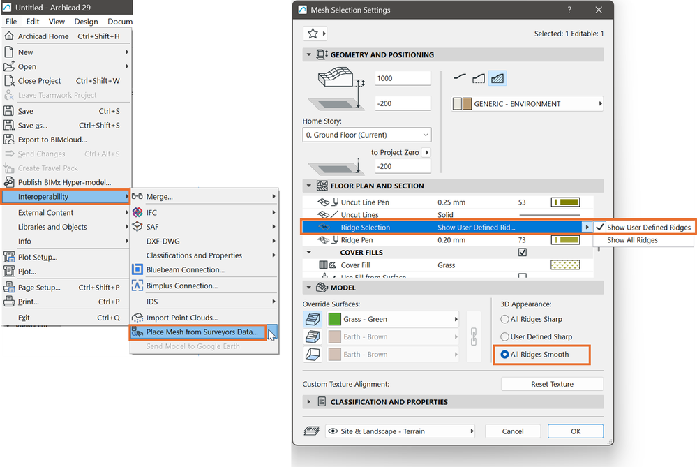

Is there a way to create a mesh with points only (no lines/ridges) from a survey (lines, poly lines)?
Mesh lines don't work for modifying the terrain later on.
Please don't tell me Archicad only has manual input of those...

To import a survey you have to clic on Files/Interoperability/import survey data (or something like that I'm french).
Mesh lines works for modifying the terrain later on too !

Hi @MrSoleil
As @Christophe Fortineau mentioned, you can import surveyor's XYZ points under File> Interoperability> Place Mesh from Surveyor's Data.
If you don't want to see the edges/ridges or points in your Floor Plan and Section or 3D views you can choose the Show User Defined Ridges and All Ridges Selection under Mesh Selection Settings for a cleaner look. Sometimes even changing or disabling the Cover Fills helps to achieve this.
