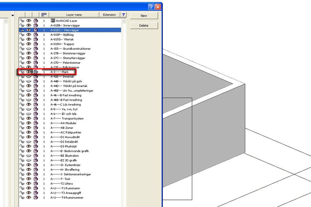

Mesh shows up wireframe in 3D and does not show up in photo
Help! this problem has been hindering my progress with projects I am working on. This problem occurs on the school program I log into and on my home program which is a separate program. I am wondering if this problem is related to the libraries and possibly the shortage of some. my computer requests that I "add" aspects to the program before opening saved progress from the project worked on at school. Again, the mesh shows up as a wire frame in 3D and does not show up at all in the photo render!
Have you checked the status of the layer on which the mesh resides?
Is it so that the mesh layer is set to wire frame?
This was a new feature introduced in ArchiCAD 8, were by one can have elements appear in wire frame regardless of the 3D window state.
You can solve your problem by simply clicking on the model icon in the layers manager window (see attached image)
HTH.
