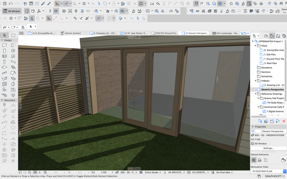

Why my mesh goes to a building? How to fix this?
1 ACCEPTED SOLUTION
Solution
Turn the mesh layer off if you do not want to see it at all.
If you do want to see it around the building, then you either have to cut a hole in the mesh where the building sits, or do a Solid Element Operation with the slabs with an upwards extrusion to eliminate the mesh above the slabs.

Thanks Barry. Resolved the problem
