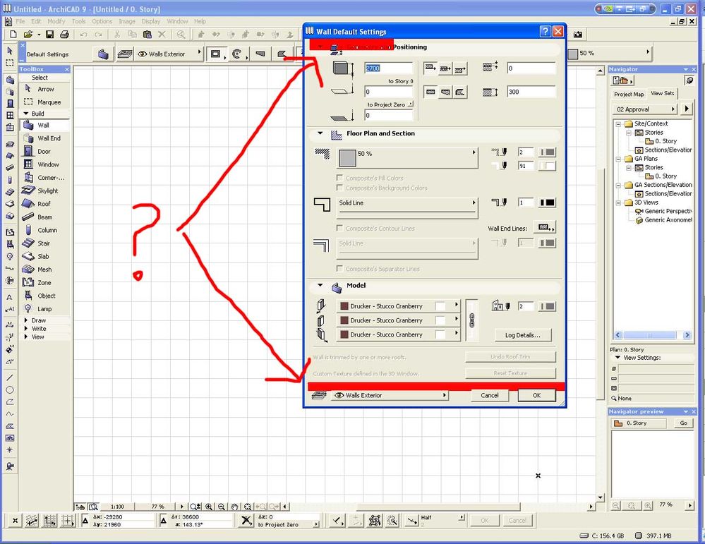

I am new to Archicad and currently going through Tutorials.
In the Wall tool i am missing the 'Favorites' button as well as the drop down menu ' listing and labelling'.
Please help
Thanks
2 REPLIES 2
__archiben
you probably have your work environment profile set to 'novice'. this is basically a stripped-down interface that takes away some of the advanced clutter until you get to grips with the basics. although it looks from your screenshot that you've been playing a bit with the WE and palettes already: you have two toolboxes in there!!!
it can be changed in Options>Work Environment...
HTH
~/archiben
b e n f r o s t
archicad | sketchup! | coffeecup
thank you! ironic that the Novice settings made my life more difficult.
