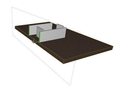

I have encountered a problem i have not seen before. I have a custom made template, that I have used for several projects.
Now all of a sudden if I place my model to the left of the origin it disappears in the 3D view but not in 2D plane.
If i then move my whole model to the right of the origin, then everything is visible in 3D. It's like the origin works as a cutting plane..
Any suggestions? See attached images!

Hi, maybe you tape the 33D cut plane " short key and have a vertical cut plane set.
Go to the "View / Elements in 3D view / 3D cutting" to verify  if it is set on.
When 3D cutting is on, to delete a cut plane be sure they are displayed in "View / Elements in 3D view / 3D cutting Plane / Display Cutting Planes"

Thanks for your replies! The issue was that I had an invisible cutting plane through the origin and that was saved to my template file..
-Jockum
