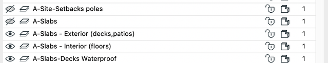

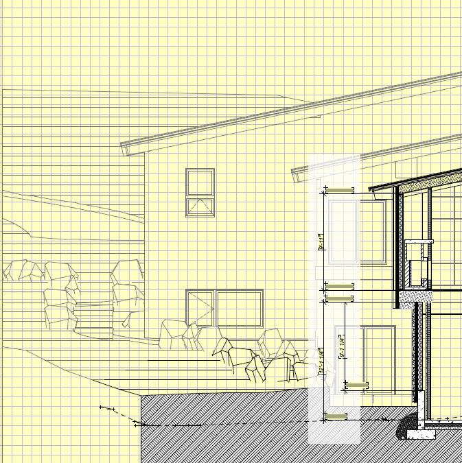

Hello,
In AC26, I can't figure out what setting I'm missing. These hardscape elements show in my 3D views, but I can't get them to show in sections and elevations. The layer is turned on.

idarchie
I figured it out. Renovation filter issue.
