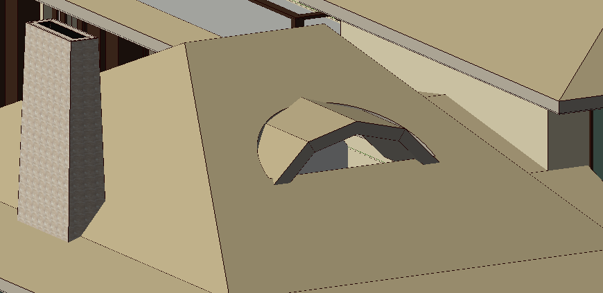

I'm trying to model an oval dormer as stated above. I seem to have 3 problems.
1. Trying to model the dormer roof I used the barrel vault roof. The problem with it is that it does not look at all round, much less like a half oval.
2. The hole I cut in the main roof is punched like a vertical extrusion. This is unrealistic.
3. I cannot create a clean intersection between the dormer and the main roof.
Can anyone help, or is my task beyond ArchiCAD ability to model?

Jesse,
Your barrel vault roof has only four little roofs.
You want enough little roofs to make it appear more curved.
This is controlled in Magic Wand settings which, apparently, you have
set to eight segments. Change this to a greater number like 36 or 72.
The word "oval" has no precise definition.
Do you mean a half ellipse, or some other shape.
There is a skylight object called "Ox-eye window" that you might use.
It has been recommended not to use the roof tool
to make barrel vault roofs. Use Profiler or TrussMaker
and SEO with the Profiler object or the TrussMaker object
as target and the roof as operator with downward extrusion.
Check out this thread. http://archicad-talk.graphisoft.com/viewtopic.php?p=56352&highlight=trussmaker#56352
You can edit the hole cut in the roof after you make the
hole by selecting each edge of the hole with the roof tool selected
and selecting the edge angle pet pallet item. Here you can set
the edge angle to be perpendicular, vertical, or custom.

Aha! I was able to get trussmaker to work. Thank you very much, Mr Devlin!
Jesse,
Magic wand settings are in the Tools menu.
Profiler is an add-on. It should be in a sub-folder inside the
the Add-ons folder. If it isn't there then it is in the Goodies folder
and should be moved to a sub-folder in the Add-ons folder.
Peter Devlin
