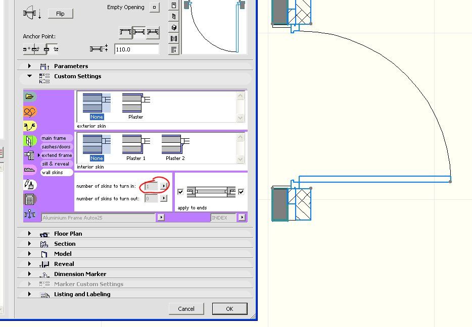

Hi Karl
Just wondering if this might help you at all. Door and Window Builder (available from CadImage) has an option to turn wall skins in or out. Haven't had the chance to use it yet myself, but it might be just what you're looking for?
(test run below, not perfect but getting there, used with composite wall, you choose how many skins of comp to turn in(or out)).
Cheers
Thank you SO much for your help Karl, you have no idea how much this helps me.
My worst fears, however, were realized concerning the lack of layer on/off for composite walls in AC.
Just seems like a lot of work and tricks to get a CMU or durisol block to show up correctly in AC in all views. I hate tricks because they disrupt the logic of the CAD package. It's like patching a pair of jeans.
Going about it the GDL way, does AC then remain advantageous over let's say AutoCAD? Can I quickly move a wall in this way or does it all of a sudden involve more work?
I'm really just trying to find the right CAD package to model the Durisol blocks, and have the ability to change drawing plans quickly. Accurate plans with no "tricks" would be great.
I guess I have a tall order. I was hoping ArchiCAD would save me from the perils of the AutoCAD interface (which I despise with a passion).
Thanks again for your quick response. Greatly appreciated.

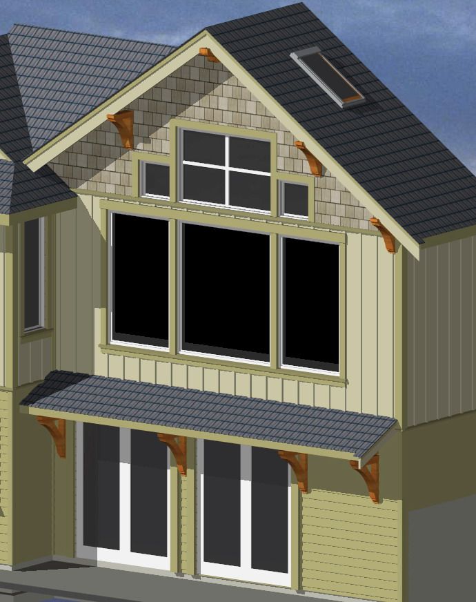

I thought I would wade in here.
I purchased the Accessories package from CadImage a while ago because it could do a board & batten surface which I needed for a project I was doing at the time. I was very happy with 90% of what I could do with it. They just updated it awhile ago and they fixed some of the issues I had with it. It can now do curved walls and has very good control on pen settings in both the 3D & 2D windows. I just did this up quickly and I don't know if it would satisfy your requirements. I did it with one of the styroform block wall systems as the main wall which you could show differently for your purposes and then added a brick veneer with the accessories tool with a 1" airspace. You can control all of the trim around opening with the surfacer rather than using the trim around doors & windows. I find this works very well. For what it's worth.

As it seems I could only add 1 attachment at a time I am posting a view of a project I did with the CadImage Accessories on all of the walls shown. All of the horizontal, door & window trims are part of the wall surface. As these are on there own layer I can turn them on of off depending on what I want to show.

Gerald wrote:
I purchased the Accessories package from CadImage a while ago...
Gerald,
That is perfect, and your rendered post is excellent. I have several clients who will no doubt switch to this package based on what you've accomplished there.

One thing I should add is that the CadImage Acc. package has the ability to extend the surface above or below the wall to which it is applied as well as doing angles. This has long been a wish for composite structures which of course would still be great thing to have. It has other tools as well for the roof including gutters & soffits although I found that for complex roofs with tight valleys on the one job I tried it on it had a few problems.
No, I am not a salesman or Rep. but am finally happy to have a good tool to apply some realistic surfaces to walls which cuts down on generating good elevation views etc.
I am also impressed with their support. They often get back to me within a day or two and have added a feature to be able to add a trim piece under the sill which was a long standing wish for me. I noticed that the new SE Library finally has it too.
If you buy this tool I suggest drawing a piece of wall and trying all of the different settings out and then looking at them in 3D to see the effect. It took me awhile to figure some of them out although most were pretty intuitive. Overall I was very exited with what I could do. I definitely think it is worth the cost if you are doing residential work.
