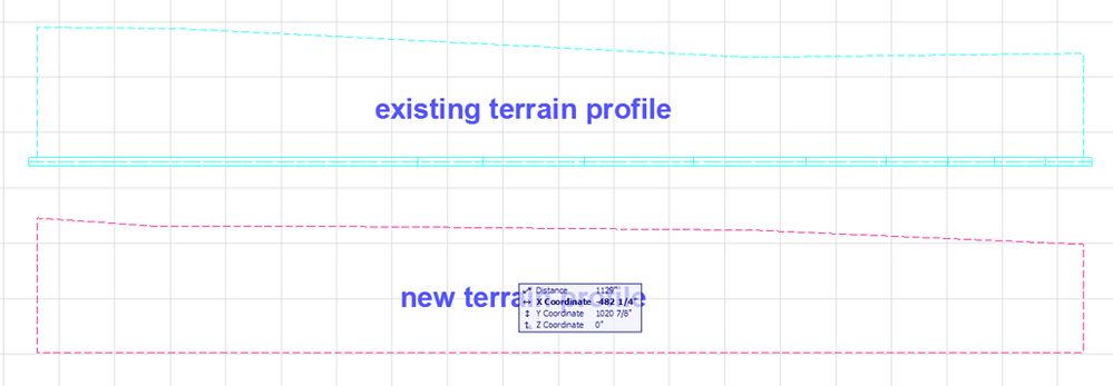

I've attached a polyline trace of a site mesh object that shows it's profile. Grades need to be adjusted to match the second profile. Does anyone have experience with this? What is the best method?

plan view> select the mesh you want to modify> activate mesh tool> click to add points/ contours as required. ref manual: page 258

Lindsay,
Don't forget to keep a copy of the original site on a layer
site.existing
Make a copy of this site and put it on a layer
site.new
(layer names are just to be clear, use your own nomenclature)
This allows you to:
- do volumetric comparisons for cut/fill calculations
- restart the new site if you mess up or change your mind about the design....
site.existing
site.new
This allows you to:
