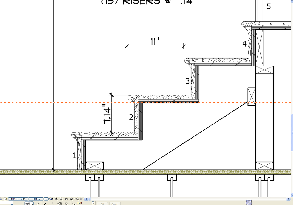

Sooner or later you will need to make a section and some details for that stair. Then you will realize that it would have been faster just to model the stair in the first place. I don't think any of those stair tools are very useful.
Model the stair exactly as it will be constructed, keeping in mind what things you need to show up in your sections and details.
Beautiful drawing Steve. Did you really model each piece of wood separately?

I would need to find my origianl file to know how much of this I modeled.
I probably modeled every part. It's a very simple thing to do.
Go to the manufactures web site, dowload the drawings of the specific parts the stair will be constructed with and trun them into ArchiCAD parts.
Nothing to it. Very fast and fun to do. And you end up with a useful model that can generate useful details and sections.

I found the file. I did model the stair parts individually, but there are actually only 4 parts, and they were something I had in my library for another project. All I had to do was stretch them to the new width of the stair. The modeled step ( tread-riser-nosing) has been multiplied/distributed with vertical offset.
Looking at all the stuff in the drawing it appears that I used my section to model the stair, rather than rather than using the model to generate the section. The step units were probably placed in plan view and then dragged into place vertically in the section view. The dimensions have been tampered with using the over ride wich tells me that it was probably something pasted in from another project and time was not taken to make it perfect for this project. Probably a different sub floor thickness on the second floor required a slightly different rise. ?? Can't tell anymore.
Also, it looks as if I modeled the stair as if it had no landing and then split it and rotated the lower section a few different times to try out different get the landing arrangements.
It's very hard to tell anymore exactly how I did it and I do not remember.
