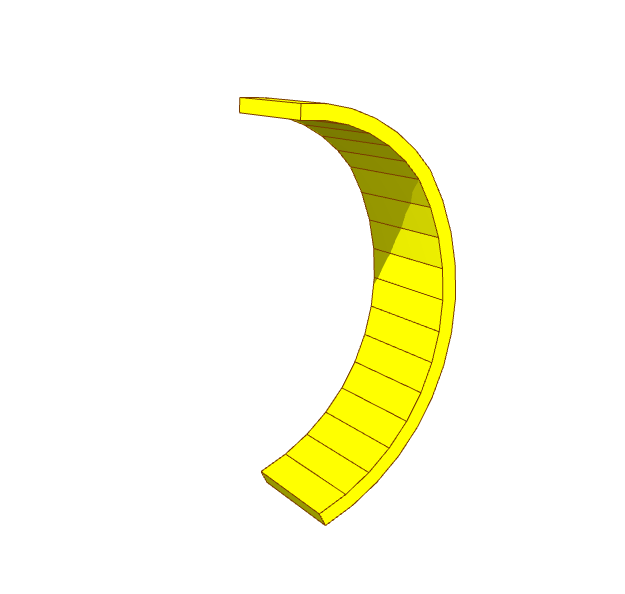

rob2218
Eduardo,
you stated that AC can create "solids" from an SU import?
how is this done?
does the SU object being imported need to be "simple"? you stated to try to make small chunks of the offending object in question.
See below what the shape we are trying to make "graphically appear" right in 2D plan looks like.
