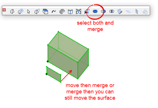

So, 2 choices.
Draw from the edge and then delete the joining line.
Or you can place an new separate line or polygon morph in the shape you want.
But note, it will be in the plane of the section cut and not on the surface of the morph.
Jump back to plan or 3D and you will see the poly-morph as a line - move it to the solid morph (you don't have to as you can manipulate it later as well).
Now you will have one morph and you can push/pull the surfaces as you want.

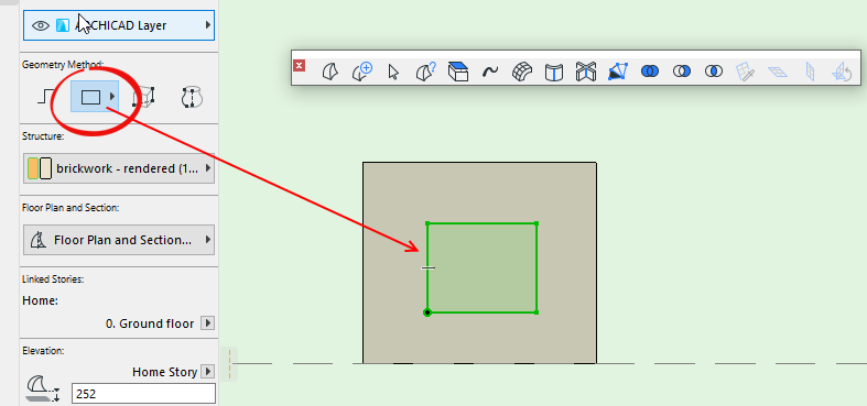

That method sounds a bit too complicated to me @Barry Kelly with using AC27.
I do like your old trick of using the “3D window and looking to perpendicular” and then we can perform the surface 2D morph operations with the select and delete method from the excellent video from Shoegnome or Jared Banks. At least this way you stay on the same plane as the original 2D morph and avoid all those other steps.
