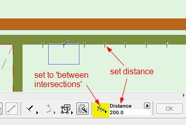

Sounds like you might want to look at using the special snap point tool.
http://helpcenter.graphisoft.com/guides/archicad-17-int-reference-guide/interaction/on-screen-input-...
Set your 6' distance and hover the cursor over the wall and you will see snap points for where you can place your objects.
Or you can use the measure tool and use the "mark location" icon (small circular crosshair next to the tick) to place guidelines at the distance you type into the distance field.
Also any figures in the tracker/measurement fields can be adde or subtracted to by using what I call back to front maths (I am sure there is a proper term for it).
Whatever figure you see you can then just type a number and then press '+' or '-' after it and it will be added or subtracted from the original figure.
So you could measure (click) in one corner, move to another corner (don't click) and you will see a distance (i.e 10.2'). Now type 6- and the figure will change to 4.2' and the cursor will move as well. Press the makrk position icon to place guide lines.
I think because you are Imperial measurements you might need to type '6--', the first dash is 'feet' and the second dash is 'subtract'.
The measure tool is accumulative and will measure around corners but you can't mark the position of a distance around a corner.
Dimentions can't dimension around a corner, you have to place 2 separate dimensions.
Actually you don't need to use that temporary vector tool (or what ever it is called).
Just set your special snap distance and set the snap tool to 'between intersections' and then hover your mouse over the wall.
You will see the snap points at the distance you set.
Thanks so much Barry, I didn't know that you can set up a special snap point... well I guess I did but it didn't dawn on me I can manipulate it in this case. Well, that solves my problem.
Too bad about the dimension, if I want I suppose I'll just put a line with arrowheads and insert a text.
Wait... it does help on a straight wall, but when a corner is involved things get complicated. I think I need to look at the 'Special Snap Points on Temporary Vector'.

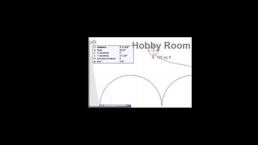

Edit: My bad, I didn't make myself clear about what I need. The previous image I supplied made it look like as if I needed to measure 6 ft. from a corner, but what I really need is to measure 12 ft. from one receptacle to another, and when they are separated by a corner it gets complicated. See attachment.
I think I know a way to resolve this, I will post back if it works out.
I found a solution that suits my needs: I used an external program called AutoHotkey http://www.autohotkey.com/, which I use on a daily basis for other purposes, to type tedious keys that need to be typed again and again. The way it works is hard to explain but anyways now I can save a lot of time.
