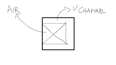

Hi, im currently struggling on modelling a wall finish element, i usually called it U channel wall reveal. so the issue is, i kinda understand on how to make it by using an object alongside the wall then use substraction command to create the reveal then later hiding the object layer thats used to cut/substract the wall. then use another complex profile for the U channel to cover the reveal. but, is there another better or more efficient way? so i dont need to create 2 elements just to make a single reveal+finish

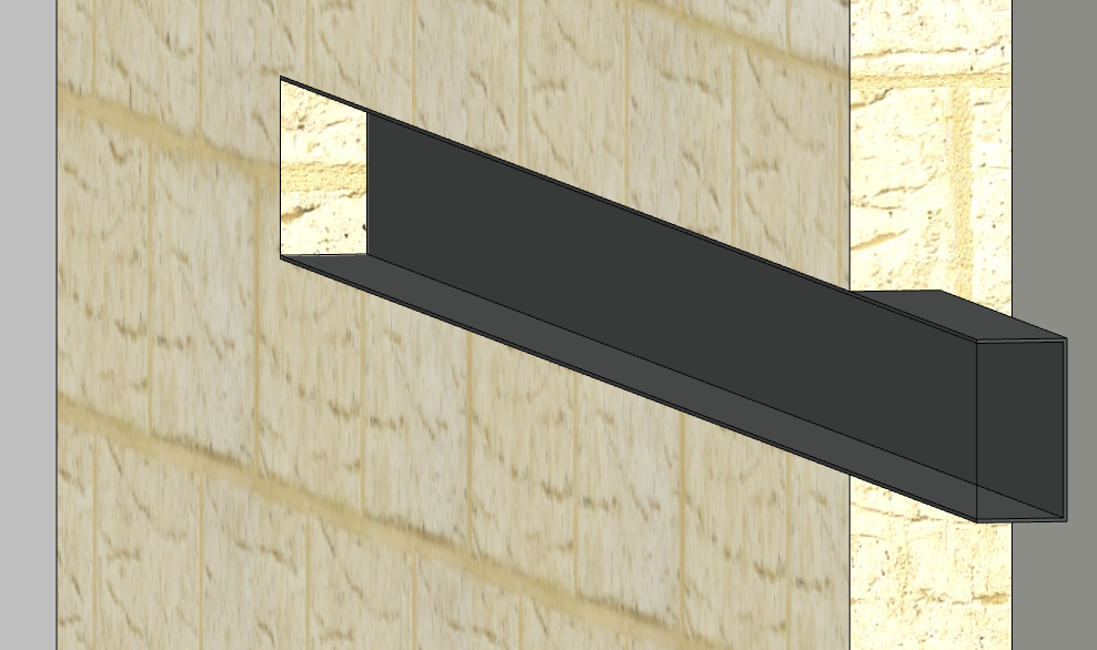

The layer that the beam is in and the wall is in need to be the same layer intersection group number.
Otherwise they will not trim each other.
Just make sure the channel and airspace building material strength is higher than any building material used in the wall.
The beam will automatically cut the wall.

What about a complex profile beam for the channel?
I am not sure if it will need an 'air space' building material in the centre - I think it will.
So long as the building materials for the beam are stronger than the wall, it will trim the wall away automatically.

wow , this is interesting. maybe i will try this , then just need to adjust the layer priority higher. then substract. time to try it

wow!, thank you this is very clean looking.. thx for the help guys!
