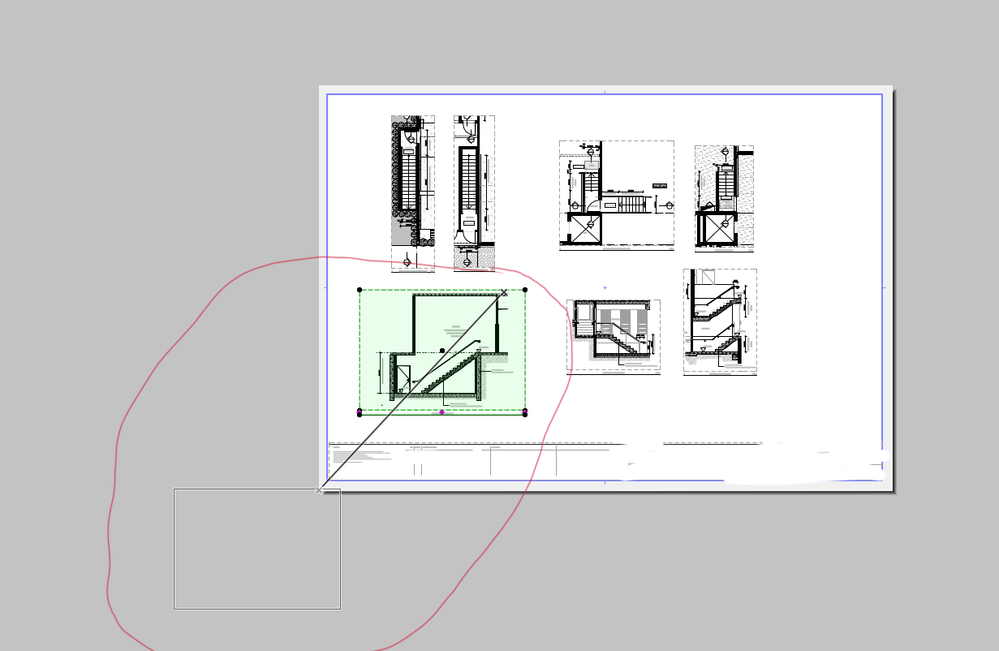

Need urgent help to work out what I have pressed
Hey I am using Archicad 18 and not sure what I have pressed but I can no longer move items or snap to certain points I have attached a screen shot as its quite hard to explain. everytime I do it trys to snap to a point down bottom of page. No idea what to search as never had this happen before...Please any help would be appreciated as I have a deadline due and need to get this fixed
1 REPLY 1
Eduardo Rolon
Under the View Menu check that you have not turned "Grid Snap" to on.
