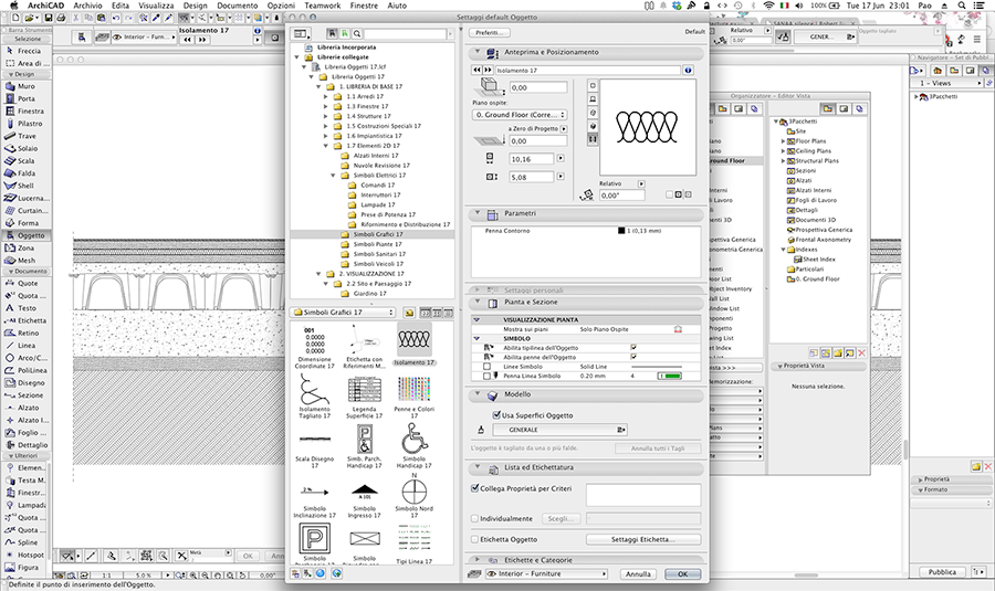

Hi Barry just to let you know I found a way around it by sheer chance: I was putting some 2D objects in a drawing today and I came across this: the insulation object! Just put it in and change it as a normal object! No need to fill and it fits perfectly. It is in the library under 2dObjects and it comes both vertical and horizontal
