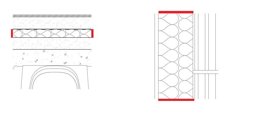

Here is another problem with fills (as if the one I had wasn't enough..): The fill for insulation needs to be once vertical and once horizontal. How do I do it? I made a copy and rotate it but when I do it both fills rotate of the same degree. Any idea?

Sorry I forgot to mention it is a 2D drawing not a 3D...

In you 'Fill Types' dialogue (where you set the fills up) just duplicate the fill and then set an new rotation angle for it.
Rename one as vertical and one as horizontal so you know which one is which when you go to use them.

Yup, I did it but I messed up somehow Now I have reanamed both and it's ok! Thanks Barry! You're my fill guru

Hi Barry just to let you know I found a way around it by sheer chance: I was putting some 2D objects in a drawing today and I came across this: the insulation object! Just put it in and change it as a normal object! No need to fill and it fits perfectly. It is in the library under 2dObjects and it comes both vertical and horizontal
