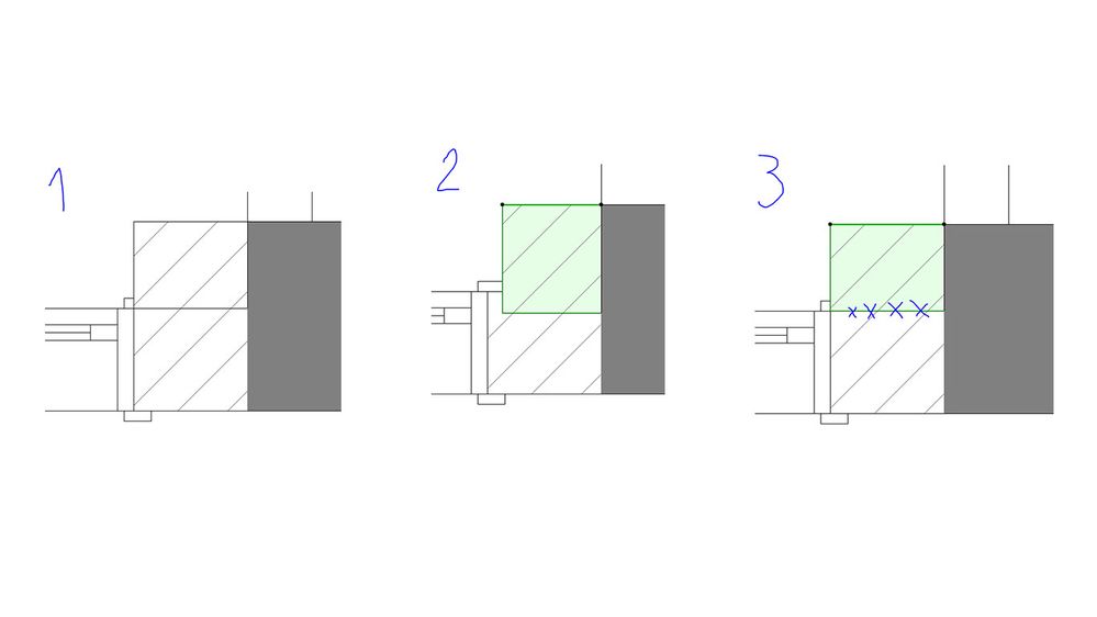

1.Wall cleanup:
If i have 2 adjacent walls or overlapping ones, how can i make the separator line be gone? (I tried the solid operation and didnt worked)
2. Wall End:
As you can see , the ends of the drywall isnt right. I tried to use the wall end tool but with zero success.

In answer to question 1 the adjacent or overlapping walls will not clean up or merge together.
Only walls where the reference lines intersect at an angle will trim each other.
You can do EDIT menu > Reshape > Merge Walls.
This will create a single composite wall but there will still be lines between.
You can then edit the complex profile to merge the fills and remove those lines if you want.
But this won't help if the walls are different lengths as the merge complex profile wall will make the merged walls the same length.
The side lines of a composite wall can be turned off in the complex profile editor but this will affect all walls of that type and along the entire length of the walls - not just where they merge.
Placing a column next to a wall (both with the same building materials) will merge with no line between.
So you adjacent wall could be a long thin column.
