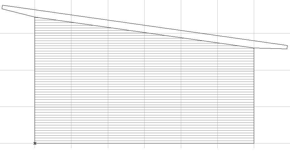

Visual creatures indeed...
Attached is a 30 second basic dwg (elevation) of what I want to create. The roof lines represent the outline including linings for the roof with the soffits tapering off to the fascia boards.
Hopefully a little clearer now...
OK.
1. You can model the whole thing with a mesh, but it will not have any thickness so not good
2. You can model the fascia with the roofs, the top edge is horizontal, the bottom is vertical.
3. You can use SEO to cut off the excess roof below.

Solid Element Operations would indeed be the way to go.
One question that I have, what would be the best method of creating the operator, mesh? Archicad primitive object?
I have always been a bit dissapointed in the level of sophistication of the eaves design in ArchiCAD. I think more user defined options would be good, particularly a horizontal soffit board.
I feel a wish list coming on..............
Another easy way would be to trace the end view fascia outline with the slab tool (using the Magic Wand for speed) in the plan window. Then make the slab 40' tall (or whatever your total roof length is). Select the slab, and take a 3D view from the "top" of the roof (i.e. rear view in plan) and convert to a GDL object. Place this object, adjust height, and you're done! (Oh, and you'll need to use SEO to trim the walls.)

I have finally achieved what it is I am wanting. It's not perfect as in plan the roof lines don't line up with one another and the roof does not meet the walls at exectly the right place but is pretty bloody close.
Attached is a *.mod file. of 2 roofs one above the other. The lower roof has 4 diff edge angles and the roof above has edges perpendicular. Found this is the easiest for me. Perhaps methods mentioned by you guys are better and easier and even more accurate.
Your thoughts on my method?

Too hard.
I did the attached in about 5 mins. just for the heck of it.

Hi Richard,
I was able to do that as well, however, the problem I was having, was maintaining that tapered soffit to all four sides of the building.
Michael wrote:
Hi Richard,
Oh, you've got the taper on FOUR sides? Sorry, I didn't pick that up from your elevation view.
