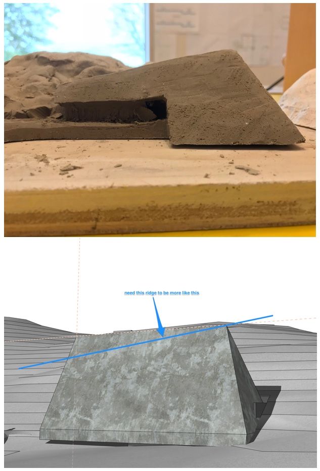

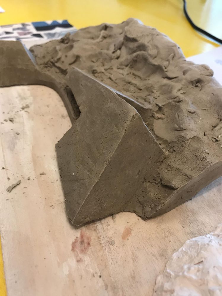

Hi.
I'm struggling with how to make a roof ridge that is not horizontal. I'm just beginning this BIM model and will naturally be working on it for the next 2-3 years so the solution has to be practical in terms of future skylight, sections...
What is the best way to approach this?

Unless the gutter is sloped as well or your building footprint is not a rectangle, you will have to bend or curve the roof planes to do that.
If you do want a sloped gutter or a trapezium footprint, the ridge will be sloped.
Build your model with cardboard and you will see how the roof planes work.

There should be no need to curve that roof...

But I'm not inventing anything... The roof is flat.

Your roof pivot lines need to form a trapezium shape, that is the only way you will make that shape, without splitting that triangle in to two triangles or twisting the roof in to a curved shape.

I'd just like to drop the Mesh to Roof command.
Might be helpful here.
Thank you, both of you.
I was hoping there would be a solution where I could use the multi-plane roof, and easily adjust the angles as the project develop. It seems I have to use single-plane roofs, which is OK, but a bit more work...

If your roof planes are not parallel with each other, your ridge will not be horizontal. It will slope up or down.

Yes, the multi-plane does that...
Unfortunately the moment the footprint becomes something else than a rectangle the top ridge point is un-movable? That is very inconveniant at such an early stage...but probably because of geometry constraints.
