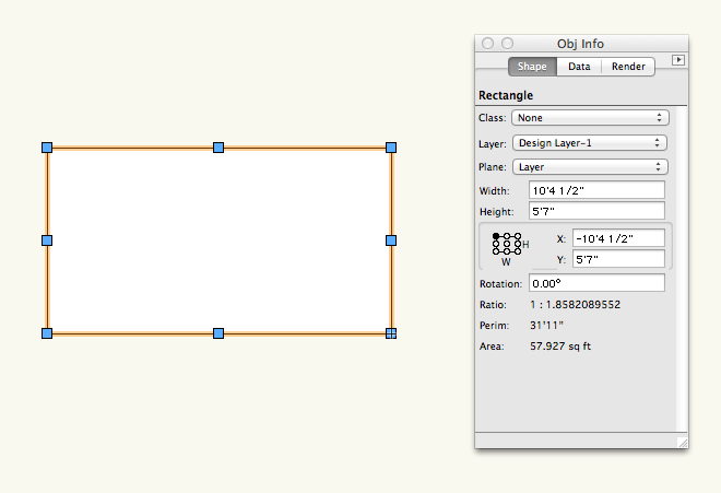

I have been a long time vectorworks user. But want to move up to ArchiCAD now.
I was trying to do a pilot with one of my projects. But i have one basic question about 2D drafting.
Most of all i am missing the "object info" palette of vectorworks. This palette gives a all the info about the selected object. For example if you click on the rectangle, the object info palette will give the height, width, area perimeter and and you can change the various properties of the selected object, right from the palette itself.
Is there not such thing in ArchiCAD?
Any help would be greatly appreciated.
ArchiCAD 20. MacBook Pro 17", 2010
+ core i7 4970k Hackintosh

justdhruv
thought i'll post one more screen shot for the object info palette.

But even so, i am at a loss to understand that, if i there is an object on screen, then the only way to know about it's dimensions is to measure it.
in fact i am having a tough time ( probably because i do not know) in making the property lines of the project. None of the tutorials i have come across talk about this.

Eduardo Rolon
There are multiple ways to show Element Information in AC, all different from VW.
- First you can open the Element Info Palette under Windows->Palettes
- Also you can hover over the object and AC will show the tracker (blue box stolen from Autodesk) which will give Information about it. If you need then click on the object and you can press different keys to edit the element, for example; D for distance, X for distance only in x-axis etc.
- Third option is to select the object and do Command(Control in Win)+T which will give a window with all the parameters that can be edited. This is the same info that is shown in the Info Bar also. Normally this contains all the items that can be edited except length for which you will grab the object by the handles in almost all windows and stretch it.
Hope this helps

justdhruv
Thanks ejrolon,
Thats what i am talking about. Thanks a lot. This is a beginning. I will trouble you guys again.
