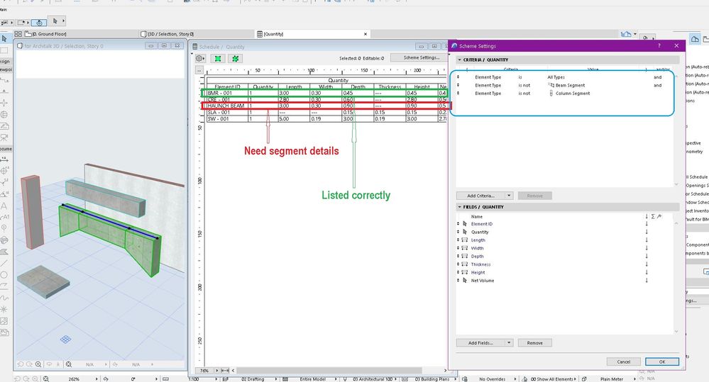

ratnabhirud
Hello,
When there are simple rectangular beams and Huanch beams (contains 3 segments) designed with segment option,
then it is not possible to list all beams in one single schedule. I have to list Hunch beams separately.
Is there any solution for it?

Could you show us a screenshot of how the Scheme Setup Dialog is set up and what is the resulting Schedule?
ratnabhirud
Hi Laszlo Nagy,

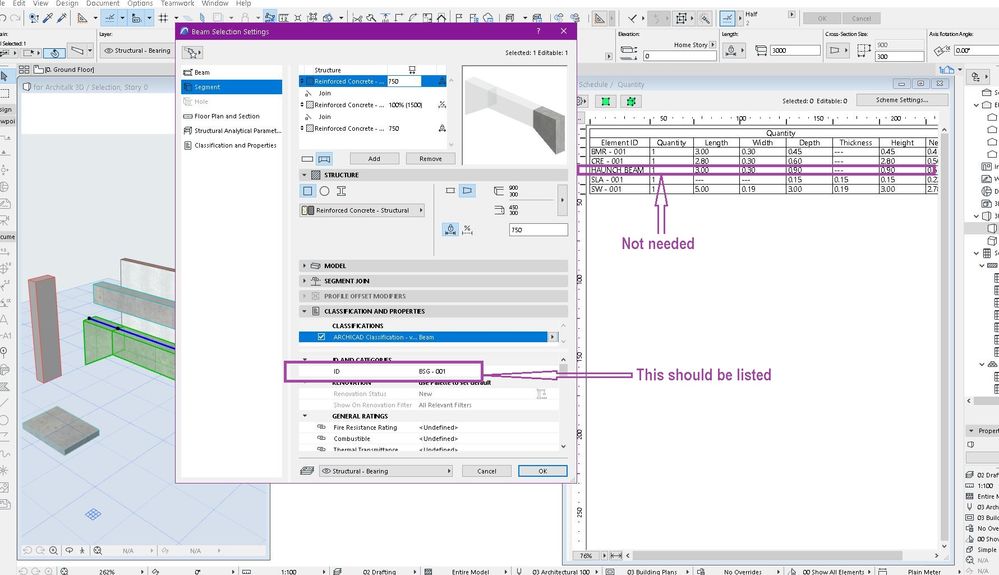

Change your Criteria so it is:
Element Types IS Beam OR
Element Type IS Beam Segment
ratnabhirud
Hi Laszlo Nagy,
Here is I am sending screenshot by doing changes as you suggested though I have already tried it before.
Fields marked with arrow are not needed but still they are being listed, thus making quantities double or extra. (Same problem is coming with Coumn schedule too)Haunch beam 1.JPG

That is because in your criteria you have both beam or beam segment.
A beam is a beam and has beam segments - that is why they are listing twice.
You want just one in you criteria.
If you want just the entire beam, just use beam.
If you want info on each beam segment, then use beam segment.
ratnabhirud
Hi Barry Kelly,
Thanks for suggestion but if you see earlier post in this thread, i have done it that too.
This problem occures when simple rectangular beam and segmented beams comes together in a project and we need schedule for simple beam as normal but for segmenetd beam we need listing for individual segment.
