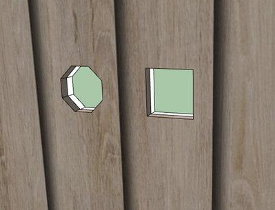

It is frustrating that the opening tool allows for complex opening shapes to be created and then there is no way to save the opening for using it again - unless i am missing something.
Sample the complex opening and I get a square one when I place the sampled opening.
Save the complex opening as a favorite and when you place the favourite it is square.....
Am I just holding my mouth wrong??

It seems the Element Transfer Settings will transfer the opening size - which was fine when it was only round or rectangular.
But now we have polygonal shapes, this has either been overlooked or maybe it is just not possible.
It would be nice though.

I think it's because The Element Transfer or Favorite are for Pameters, the shape of the opening is it's geometrical construct like when you draw a Slab shape, you can't transfer this nor save it as a Favorite. This is not possible for all other Tools.

I accept that the tool was not designed to do this, but it should allow for saving out a custom opening, and you should be able to create a favorite to place it again.

Yes you are rigth it should be possible or at least like for Slabs and other tools be able to Translate with copy.

Yes, this should of course be handled by a proper type functionality which favorites could be developed into. GS being content with favorites just being some sort of autofill is rather strange given their outspoken aim to increase our efficiency. And it doesn't look good when compared to most modern CAD/BIM applications.
I think what happens here is that Favorites can store only the various parameters of elements. When the Opening is rectangular or circular, its stored size parameters are enough to determine its actually shape. However, when it is polygonal-shaped those parameters do not apply so the shape is not saved, the same way the shape is not saved for a Slab or Roof or Mesh and so on.

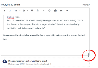

First off - I seem to be limited to only seeing 4 lines of text in this dialog box on the forum. Is there a pop this into a larger window? I don't understand why I am limited to this tiny space to type in?

@gdford wrote:
First off - I seem to be limited to only seeing 4 lines of text in this dialogue box on the forum. Is there a pop this into a larger window? I don't understand why I am limited to this tiny space to type in?
You can use the stretch button on the lower-right side to increase the size of the text box.
