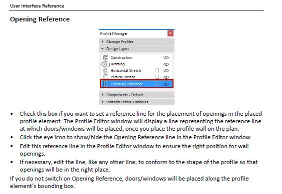

In the profile editor you can set the position of the opening lines by dragging them.
There is an option to show them if they are not already (just like turning a layer on/off).
At least that is how I thought it was supposed to work.

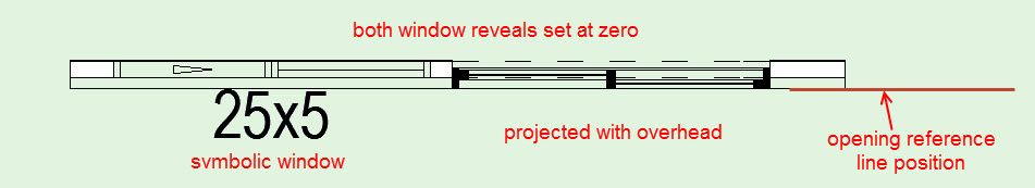

OK a quick bit of testing.
A complex profile wall can not have a 'Symbolic' floor plan display - by default it is "Projected with Overhead'.
If the window being placed is 'Symbolic' then it does not use the opening reference line.
However if the window is also set to "Projected with Overhead' then it does use the opening ref line.
I would still consider this a bug.
I like my windows set as 'Symbolic'.

Defining the opening reference line in the complex profile fixed this.
I am using 'symbolic' for openings, and that seems to be working correctly for me.

I can manually set the reveal depth but the problem is the plan will move from the edge of the wall and in 3D it will move from where the opening reference line is.
So it only works if the opening ref line is on the face of the wall so 2D and 3D match.
Karl wrote:
Also, I notice one window has the interior skin turned in and the other doesn't. I don't know if that makes any difference, or if there are different settings between the two windows.
This is just because one window is symbolic and the other is projected.
Another reason to use the symbolic as it shows the reveal returns.
But the problem is the symbolic view does not use the opening ref line in plan.

That's why it is working for me - I have the opening reference line positioned at the exterior face of wall. However, this face of wall is inset from the face of wall above the opening, so the reference line is useful in that it allows me to select the relevant wall face. I expect that if I moved it off a wall face, would behave as you note. But I'm trying to get this project done, so I'm not moving it!
