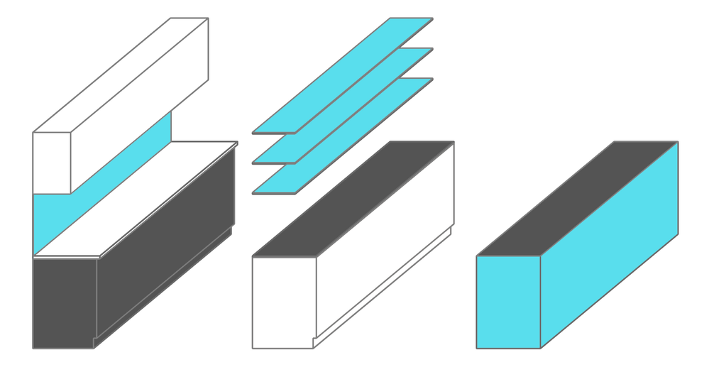

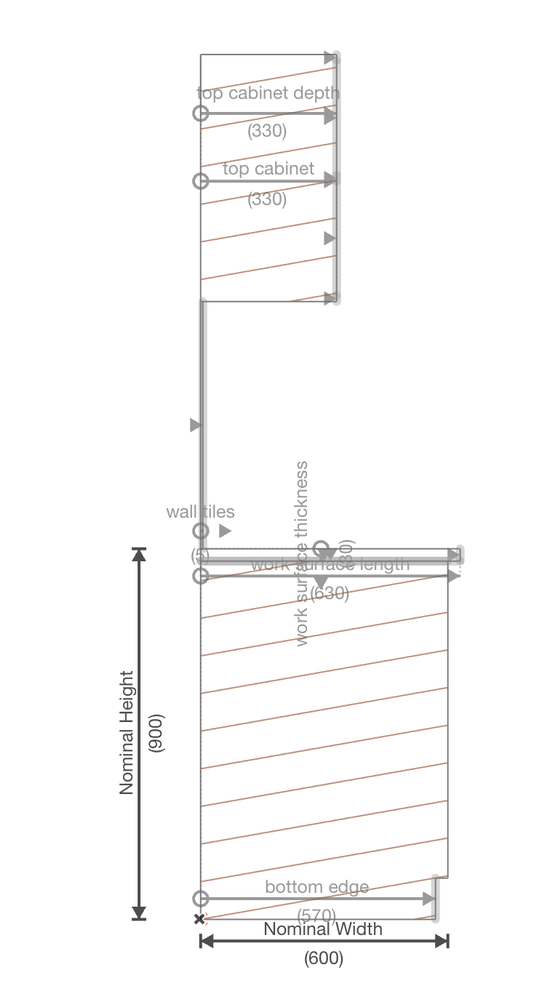

This particular example covers a schematic kitchen cabinet, created in the profile editor, with some of the edges set to be customisable. Follow our other articles how to create customisable skins and edit multiple edges with the same modifiers. Modifiable parts in this example:
  • work surface thickness and length
  • wall tiling
  • top cabinet shelves and depth
  • bottom cabinet footing

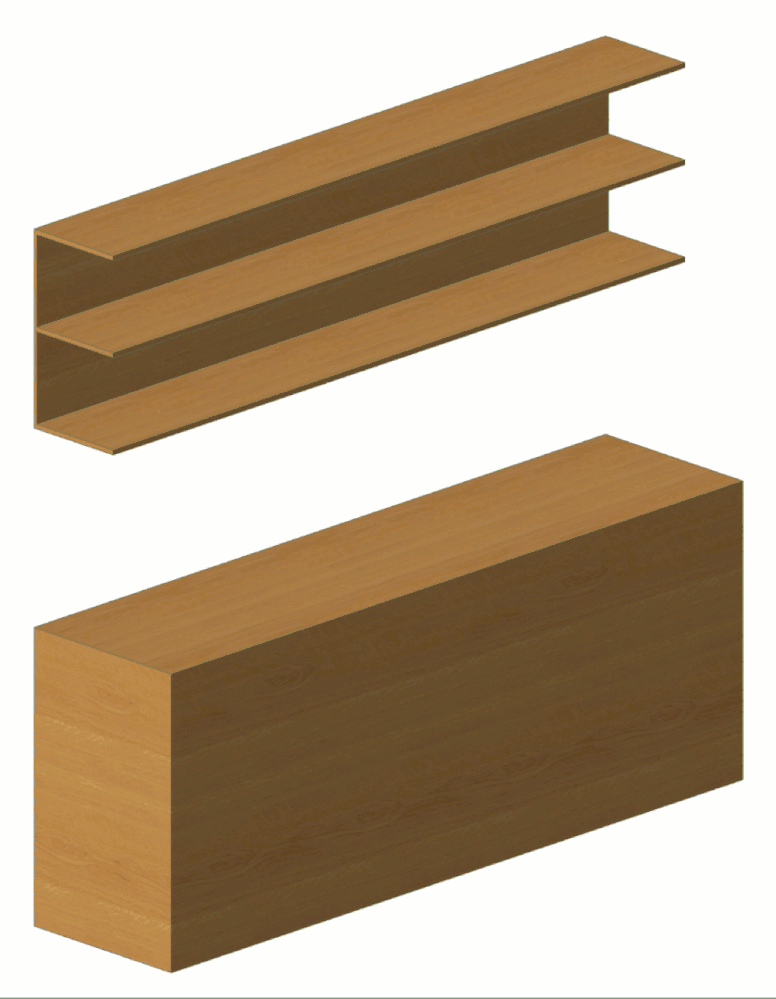

Place and Edit In this example we used the profile as a wall, which then can be placed in a floor plan or a 3D view.
  • Select the element to highlight the modifiable edges
  • Drag the lines in 3D or edit an exact value using the Tracker
  • Create design variations

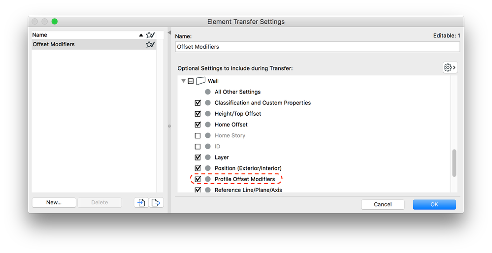

Use the Element Transfer to distribute design variations The Element Transfer Setting now include the Offset Modifiers as an optional Setting for Wall, Beam, and Column elements.
You can set up and save new Element Transfer Settings to use to spread variations across the project easily.
