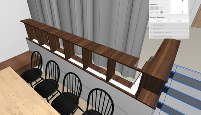

Hi There,
I seem to have a phantom wall appearing in my 3D that is cutting into elements in my model. It doesn't appear in my proposed floor plan and Ive tried looking for it as a demolished wall but it doesn't appear there either.
I've tried to turn on all layers, and it doesn't appear.... It just keeps on cutting into anything I put in this area.
Please help.
Kate.

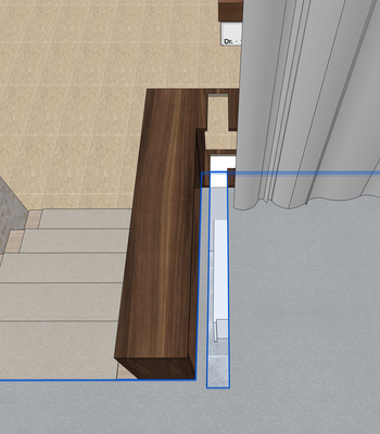

K_Archibald
It also strangely only seems to cut through slabs and not walls...
Maybe it is a wall with a transparent material?
But usually you would still see an outline in 3D.
In 3D Style settings, turn transparency off.
Erik Bjornhage
Have you done any SEO:s with upwards or downwards extrusion?
Could this have mistakenly cut your floor?
That could be it.
Although the portion of the wall is removed in 3D, it is still there and will interact with other elements like slabs.
