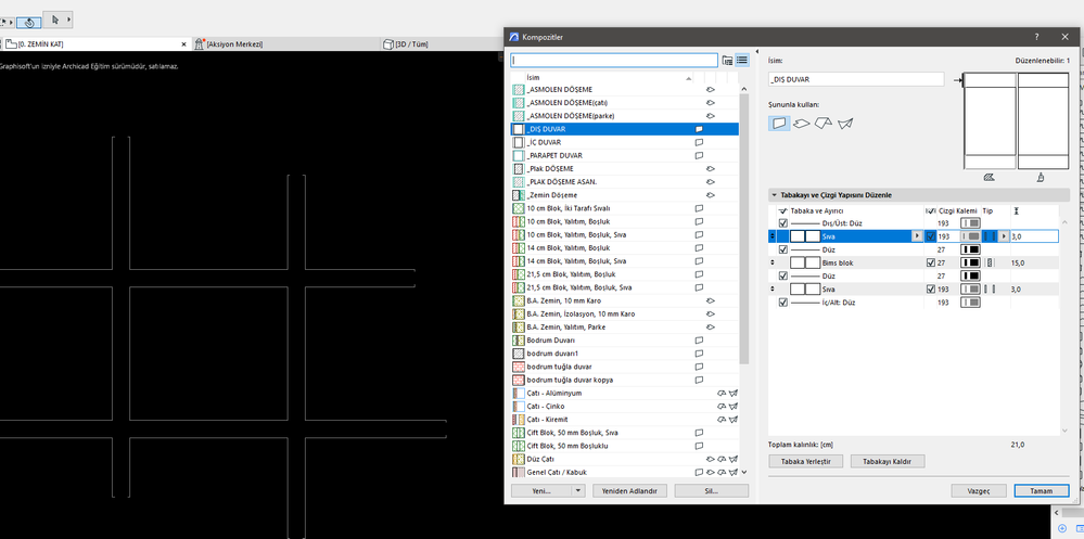

Core lines are not visible on the composite wall I drew. Can you help me

only the lines inside the core are not showing. Only plaster lines are visible at the moment. The lines of the wall are not visible

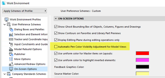

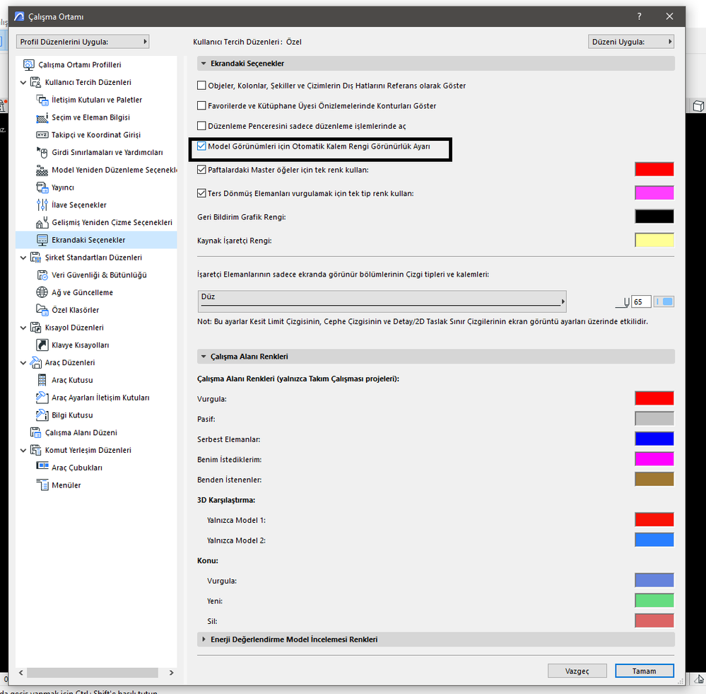

The solution is İKİKALEM in architecture. Model display options with black base should be corrected. As seen in the photo

Check you haven't got a Graphic Override active that has the "Hide Skin Separators" turned on.

normally it should be like the photo below. I checked the graphics enablement, there is no problem. How can I solve this?

Is it your Partial Structure Display settings - i.e. showing core only?

i tried different color combination but result is same
That is the automatic pen colour visibility.
