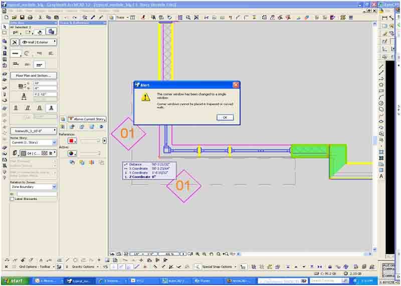

Along with this same topic, I have been working with the corner window tool and am having trouble with putting a corner window into a composite wall (that is not a complex profile) and then intersecting that wall with a complex profile. I keep getting the warning below. Has anyone seen this before?
I'm I doing something wrong. According to all the posts that I have seen, placing a corner window into a composite should not be an issue. Also, when I try to do this when I am intersecting a composite with another composite wall I get the same warning, so I doubt that the complex profile is my problem. I have not gotten around to assigning the composites to the complex profile, could that be a reason?
Tom : In those situations I normally put an empty opening in end of the walls that cut a hole. Then I put a window in that hole and create the corner manually or build the corner situation as a standalone GDL object that I put in the hole I created above.
Ok, thanks, that's what I figured I would have to do... Have you ever seen this error prompt before? Or is it basically just telling me that this command cannot work with my wall geometries?
