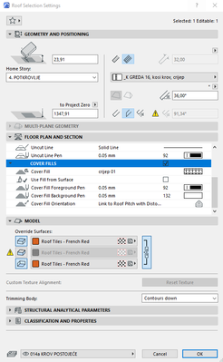

Why is it that I can see my ridge tile in 3d and not in plan view ??
Any ideas ????
Many thanks
Myles.
2 REPLIES 2
filip
Turn on the cover fills in the settings to see the tile in the plan view.
