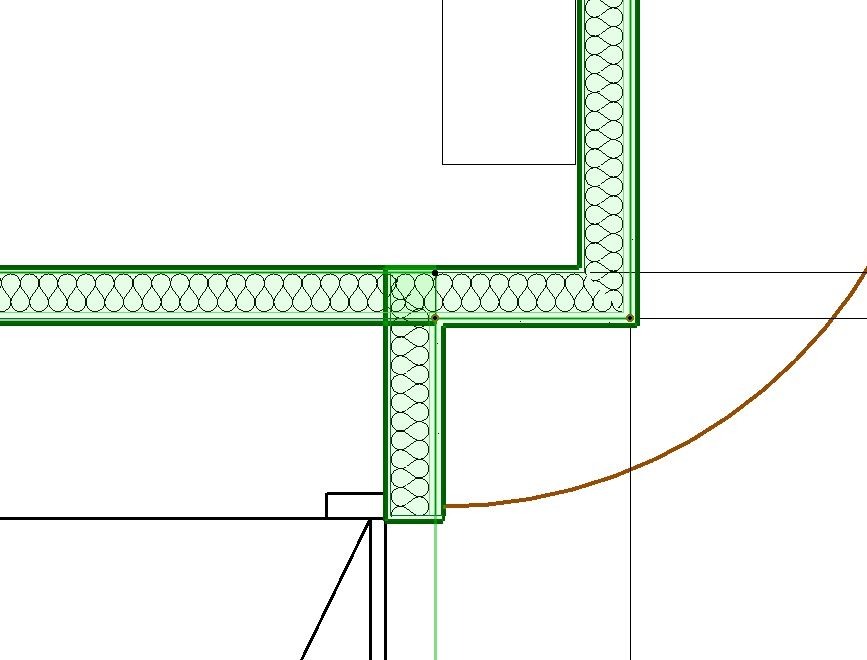

Okay this jpg. below shows clean wall intersections, but I had to put the reference lines wherever they needed to be to achieve the clean (correct)
representation. So, whatever logic I thought of in the original placement and location within the wall is completely ridiculous isn't it?
Reference line placement within the wall is best used to get the intersection to
read correctly right? Then it follows that one probably should not do the building plan dimensions untill all of the intersections are correct?
Does all that sound right? Or, am I missing the boat?

I have been able to keep the Wall Reference Lines where I want them, so I think you should look at some other options.
In your first screen shot (2 by 6 walls firecode gyp to stucco.jpg), do all the wall layers have the same Layer Intersection Group Number? That was the only way I could reproduce your image.
Also use the Walls' Junction Order (Help file: Virtual Building > Construction Elements > Element Intersections > Specific Element Intersections and Junctions) to help change how 3 walls interact at a junction.

Good morning David,
I did manage to get all the intersections to clean up yesterday by manipulating the reference line location within the walls (found some old posts, via search, and that's what they were doing). Then, before going to bed decided to go ahead and correct all the dimension strings that had been adversely affected.
Thought I would be able to move on today until I read your post...Ugh.
Was just explaining to my wife about how I haven't a clue about the two concepts you brought up when I realized that I do know about one of them. The Layer intersection group number! Haven't had to use this for
years, but remember it having a profound graphical effect. Going to see what I can find out about the walls' Junction Order now. Not sure if I know anything about this or not.
I think the right thing to do here, is to put everything back (I think I saved a file somewhere from a couple of days ago, before changing the reference lines)...No that won't work, will have to go backwards to move forward. Here we go again:-)
Yes, my interior and exterior walls have the same Layer Intersection Group Number. Do they need to be different numbers?

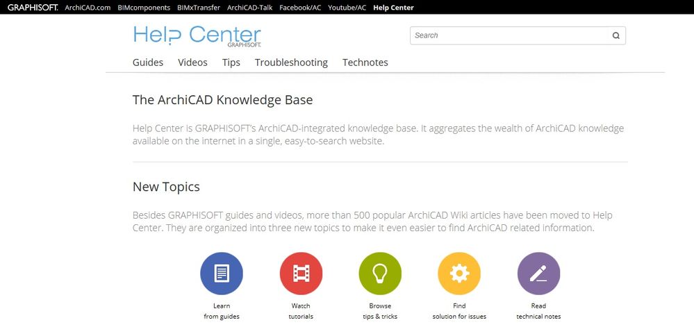

After several attempts to follow the string:
Giving up for now - The help file takes me to the jpg below and if I search virtual building it takes me to earlier versions of archicad info for pre BIM explorer stuff.

In the search box try "Specific Element Intersections and Junctions", it should take to to a link for this page:Specific Element Intersections and Junctions.
David
David Maudlin / Architect
www.davidmaudlin.com
Digital Architecture
Thanks David.
The link took me there and I saved the page in favorite places to look at when I have time. Looks like good stuff.
