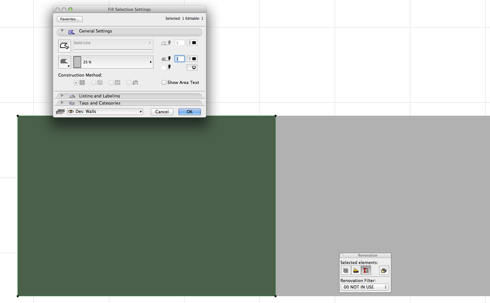

Hi I'm having a little issue with fills.
The attached image shows two fills side by side,
- both are 25% Pen 1 (Black)
- Left is set to window background colour, Right has the background set to a white pen.
Obviously the background of the window is white - so any ideas why the fills look so different? (did I miss an override somewhere?)
Thanks!

I didn't know about that automatic adjustment, thats useful. However, that only makes a slight difference to the colour. As you can see the difference is quite substantial.

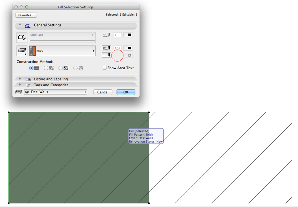

Two more images (I can't seem to add images to the previous post)

My workaround at the moment is to:
- toggle the background fill override
- chose a colour,
- chose the window background again
- toggle the override back off
that seems to get the "-1" to appear
The brick material fill on the left is how it appears as default, and the right is after the background has been toggled on and off.
I see you are using a cut fill with Building Materials.
Does the same thing happen for a regular cut fill or drafting fill?
Go into your fill (surface) settings and make sure the background pen is set properly there.

It happens to all fills (cut/building material - anything that uses the background pen).
Whenever the fill background box doesn't display "-1" beside it then the background colour comes in as a dark grey.
